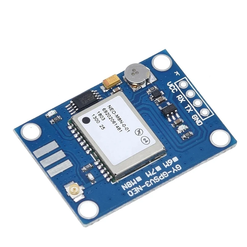

Can you send pictures of the GPS modules you installed? Do you have maybe one that wasn’t soldered yet so you can send high quality pictures of the front and back, so we can compare with working ones?
I would assume you got a different version to the ones we used to get up until maybe half a year ago (I’m not sure when the last batch was ordered). Maybe you can also post the link where you got them from.
Apart from that, it is also possible that this is „simply“ a regression in the firmware. I haven’t heard from @andreas in a while, but he might be available to check that. Or you could flash an old version from git or the release archive.

We bought them from GY-NEO6MV2 Neue NEO-6M GPS Modul NEO6MV2 mit Flight Control EEPROM MWC APM 2,5 Große Antenne für Arduino 6MV2 - AliExpress 502
I’ll let @mart-e post a picture as he’s the one having those atm. :slight_smile:
And here are two pictures of one of the module: front - back. I hope it’s detailed enough but let me know if you need other details.
And the about page :
Thank you for your assistance
Thanks for the details. From the about page I see that the usual information about software and hardware versioning of the GPS module are unfortunately not received. Digging deeper in the log output you have provided earlier, I see that some of the messages we send are denied by the module - might be there is already a hard config baked in or this is a unexpected version of the module.
0x3406 → here we flag that the gps module is configured for the OBS. This fails, is not nice but not a issue.
0x0406 → is an attempt to reset the module. There are 2 retries but after 10 seconds we give up
0x500b → this is about the ALP data - also not critical
0x040a → here we ask the module for its version info but we again get a NAK message back - this is not critical but we do not get details from the module :frowning:
0x0301 → we try to get the receiver status - but get a NAK
0x2406 → we try to configure the module so that for our use-case (cycling). Not critical but used to filter out faulty results.
The Had to switch incomplete record message indicates that some info messages that we rely on, and expect every second has been received, but at least one had been missing.
Might be we get more insight if you increase the -DCORE_DEBUG_LEVEL=3 to -DCORE_DEBUG_LEVEL=5 in platformio.ini or if you use it in custom_config.ini. To reduce the log output from the distance sensors also comment out the log_v("Raw sensor ... in sensor.cpp line 351…353. Before sharing the log, please make sure to remove sensitive parts. The WiFi config including credentials is dumped to the log on that level.
In summary the startup with 115200 indicates a more modern module but the refusal of some of the messages we send could indicate a older gps firmware.

I hope it helps
Thanks for the log, and sorry for the wait.
Basically, it confirms my assumption. The module only understands part of the UBX messages we send, and it only reports parts of the messages we expect ( NAV-STATUS & TIMEGPS). It might be a fake, or it could be an earlier firmware version that we do not support. The U-Center tool could provide some insights here.
To reduce the risk of a firmware issue, I also performed a configuration reset on my GPS module—it was well detected and initialized. This is not a 100% test, as you obviously have a different module, but it’s what I can do without having your module in hand.
The options I see:
  • Replace the modules with supported ones.
  • Check if the missing data can be filled via the „NMEA“ messages and parse those (this is likely but would need to be implemented).
  • Analyze in more detail which messages are supported by this module to reduce the effort above. The U-Center software can help with this.
Parsing the NMEA messages might also enable support for other non-UBX modules—if that’s something we want.
Thanks for your help @andreas
I can certainly implement the missing parts in the parser. But before doing so I was wondering if it wouldn’t be easier and more robust to use an existing parser such as TinyGPS++ as suggested for example in this tutorial.
Is there any reason you wrote your own implementation rather than using something like this?
TinyGPS does not support the UBX protocol which allows us to use enhanced features of the GPS modules like assisted GPS. TinyGPS was used till version 0.4 of the OBS firmware (mikalhart/TinyGPSPlus) a lot changed since then.
Hi!
We have been successful to get UBX data with the following module:
We did see that an update of openbikesensor firmware was available today so maybe it helped?
On the other one, mentioned above, we could not get info. We did succeeded to use u-center but don’t seem to be able to update the firmware nor activate UBX. Either we haven’t found how (u-center is not very intuitive) or we got a bad batch of GPS module…
If it connects to u-center - can you check the version reported?
View → Messages View (F9) → UBX → MON (Monitor) → VER (Version). If the values are not filled already, press „poll“ in the status bar of the Messages Window.
Here is a sample:
If nothing is shown it is likely not a u-blox module at all. We might try to support a wider range of versions of u-blox modules in the future.
